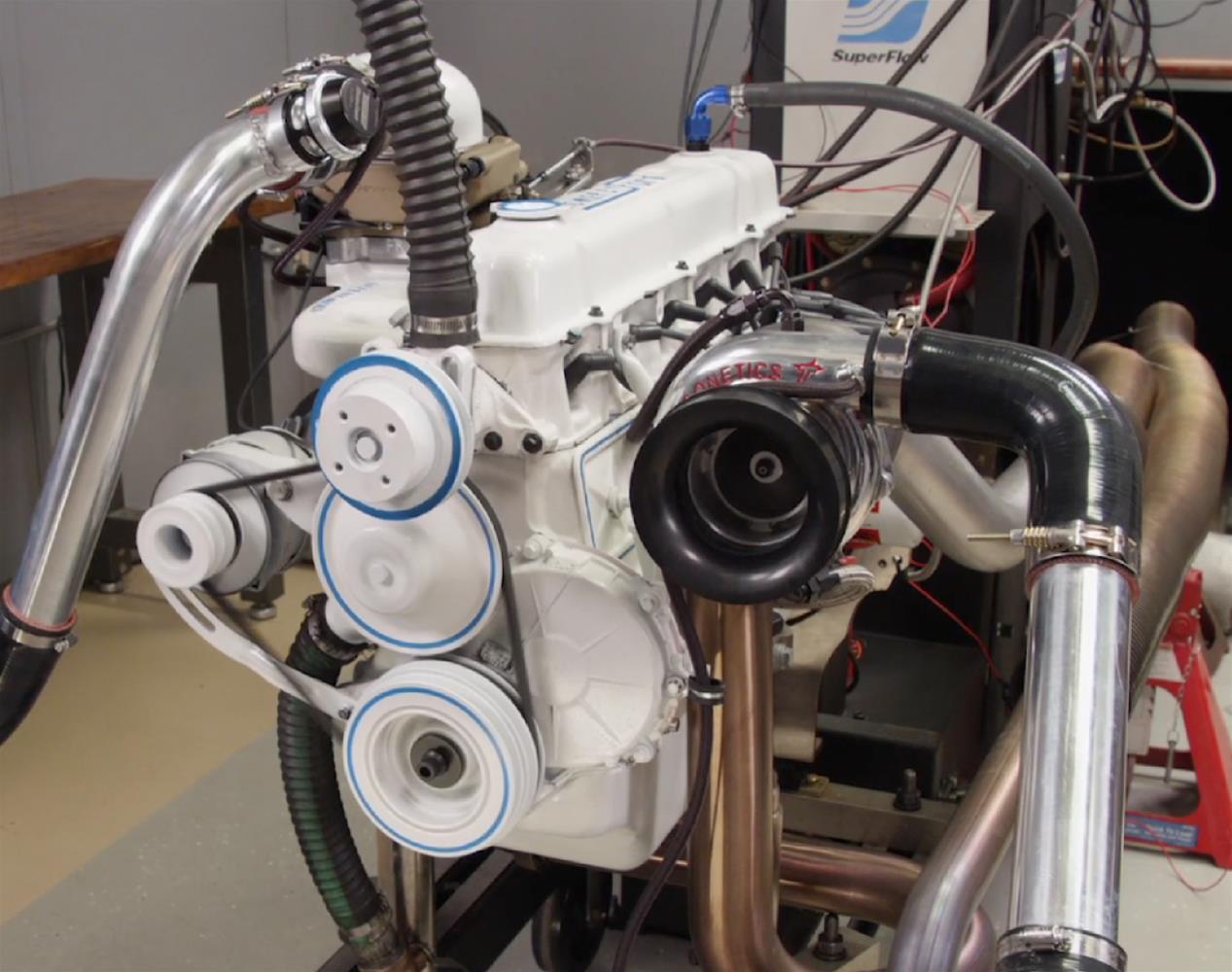

I don't see the Promaxx CNC ported head or the Comp cam that was part of the original build mentioned as needed items to make this work.
They only mentioned that a ported, big valve EFI head was used.
The HEI distributor in this kit doesn't have boost retard or is set up to be controlled by the Sniper.
The distributor in the original build had boost retard.
They also didn't mention that the original build required at least 93 octane gasoline.
