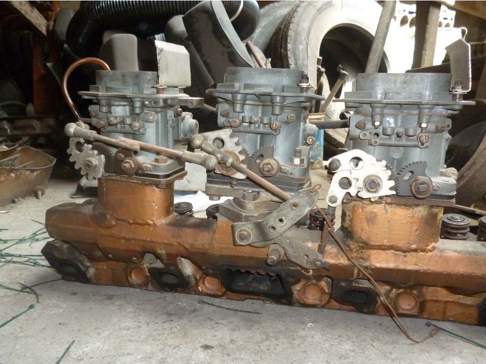

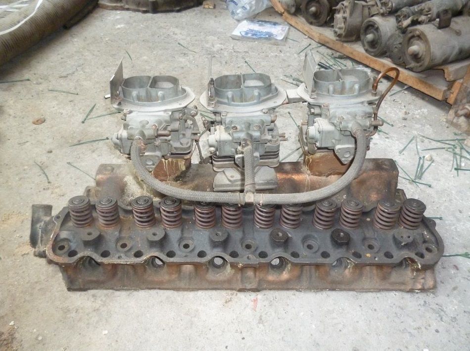

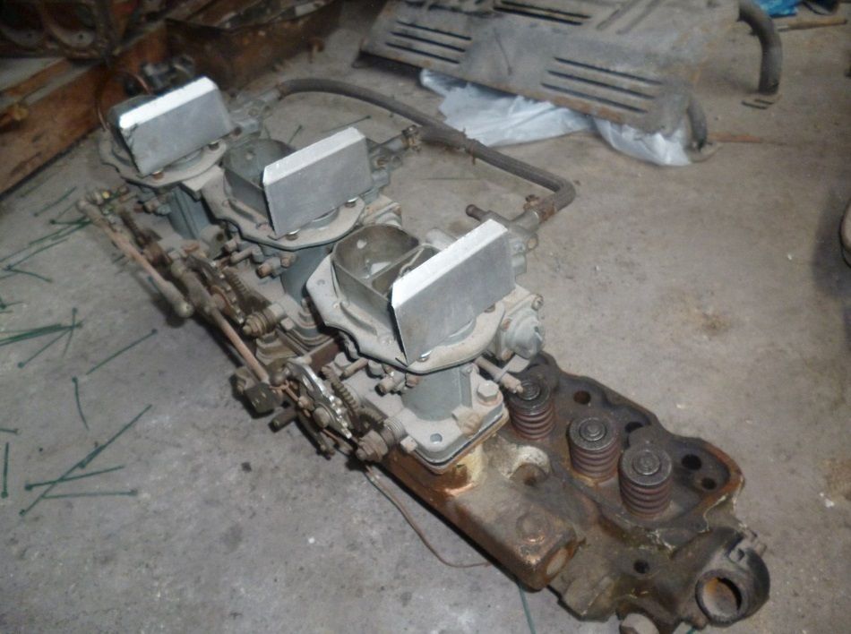

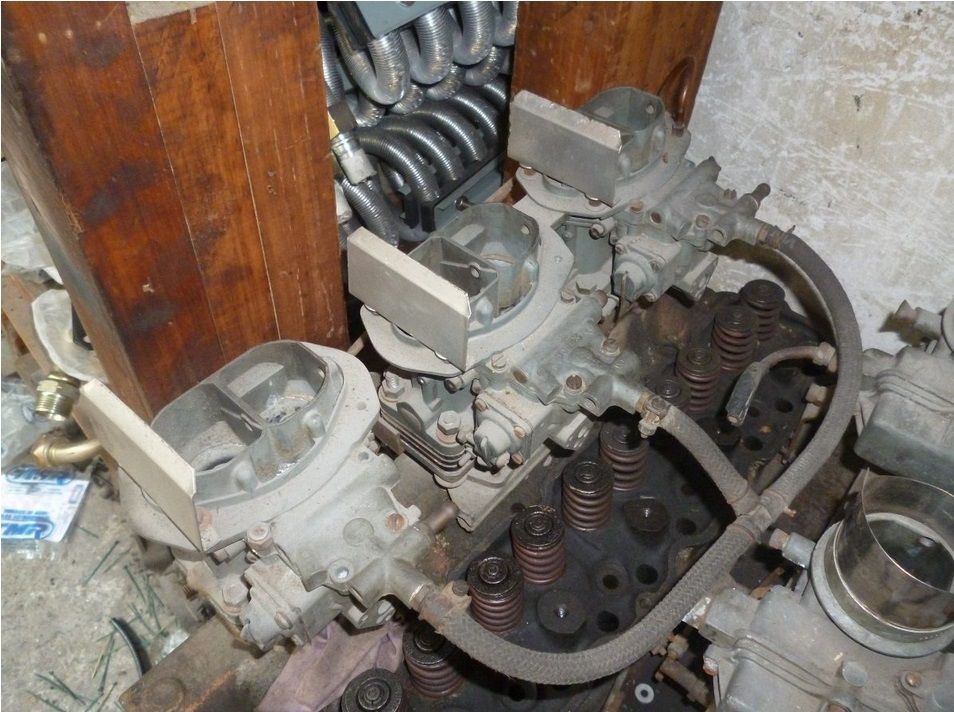

Here's a welded on log head Argie engie with triple 38's.

The head that has the triple carbs on it is the flat top Aussie and Argentine log head. ARC9-6049.
In the XY 4X4 Pickup, and the Falcon SL Tripower, both Ford Australia and Argentina slanted the engine 5 degrees to clear either the front transfer case or the carb to spring tower brace gusset.
