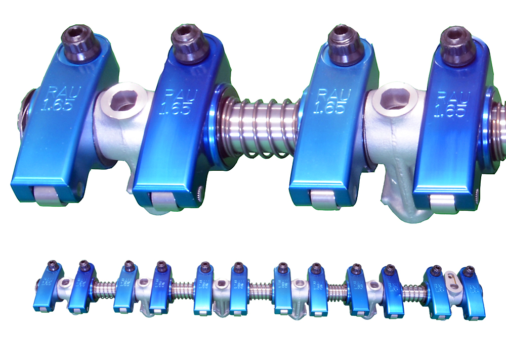

  9. Roller Rockers - RAU - F-44RA & F-44RRA? - http://rockerarms.com/pages/rollerfordcad.html

  7. Roller Rockers
    1. Yella Terra - https://www.vintageinlines.com/product-page/yella-terra-adjustable-1-65-full-roller-rocker-set

There is no doubt that the yella terela roller rockers are of a very good.quality. Recently there is also another option by custom made by Rocker Arms Unlimited that might also be worth checking into and they are located in Ca, RAU was the suppler of rebuilt stock 1.5 ratio stock and custom modded 1.6 adjustable stock rocker arm sets for Classic Inlines C. I., not sure if V. I. Matt is also using them but might be.
These New 1.65 Roller Rocker Arms aren’t listed yet on their web page but I have seen a picture or two of them and look to be real nice quality. http://rockerarms.com/pages/rollerfordcad.html
