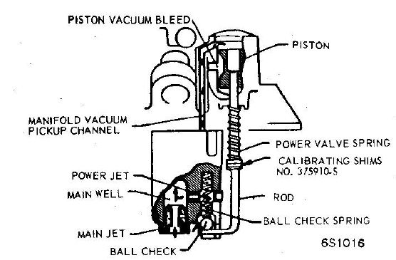

You might check your carbs power valve sounds like you could have a bad one or one that's is not working correctly :nod: good luck

Yours may have been dumping black smoke and carbon for a while, but it still likely indicates a rich condition...no offense. You could always try to clean up some of the existing carbon to help you determine how it's doing going forward, but your plugs should read a light tan. Any black build up is generally wasted fuel (just make sure it's not blue smoke, and oil burning...plugs will be a wet black, and valve seals could be an issue there).
The power valve on the 1100 is a bit of an anomaly...they are generally not considered a serviceable part...
Check out "Mike's Carburetors"
http://www.carburetor-blog.com/?page_id=246
if you've not seen that site before, for some good tips on 1100 maintenance. One might also suspect your accelerator pump could be delivering a too much of a 'fuel shot' on acceleration (tips on setting that at Mike's Carburetors and in the FSM).
Also need to be sure all check balls, and the accel pump discharge weight are in place to avoid internal bypassing and excess fuel delivery.
Primary suspect, IIWIYS, might still be fuel pressure as these aftermarket pumps put out a heckuva lot. Good on ya for keeping the 6= 8) and keep the info and questions coming...lots of knowlegable folks here! Good luck (y)
