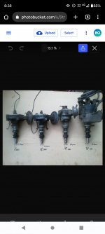

The aust bosch ELECTRONIC (HEI type) distributors never had the dist spigot( that used a 5/16 drive)that was the same OD size as the usa 1/4" drive spigots
Left is 1/4"drive loadomatic =
11.5mm dia,
Next is 5/6" drive loado = 13.1mm dia
Far right is bosch electronic 5/16" drive used in mid 80's falcon 6 in australia =12.5mm dia (approx 40 thou larger dia than an early 1/4" drive spigot ... For those non metric minds)
In looking at DSM Motorsport.com Listings for the Ford 6 Cylinder Distributors they show 3 Products​
The first two say they will suit all pre-cross flow type motors 188-200-221-250 ci engines. The last listing says this unit will suit all pre-cross flow type motors 144-170-188-200-221-250 ci engines. So to the best of my knowledge all the 144 Six's had a 1/4 inch Hex Oil Pump Drive and the Smaller Short Block Pilot Hole Diameter our early 170's (1961 to 1964) and 200 Six's (1963 1/2 to end of the 1964 Models) also had these same smaller Pilot and 1/4 inch Hex Oil Pump Drive sizes. I know that these Distributors would use the 5/16 inch Hex Drive and that's no problem since you can just swap in the 1965 Oil Pumps. These are made a little different too than the above picture of that Bosch Distributor Unit, so the question I now have is there one that can fit into those early Small Six Engines? We were told many years ago that they would and some site members here even acquired them.
