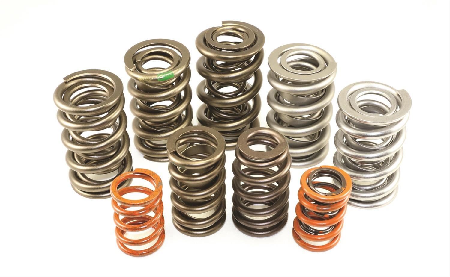

The closest I can come up with is the Isky 5005 dual springs.
It would give you about 120 lbs on the seat at 1.550" and 280 lbs at .500" valve lift.
Probably be good for 6500 rpm.
You can move the retainer up .050" with PAC-L8149 5/16" keepers.
It would reduce the Isky spring pressure about 16 lbs but then there would be room to shim across all 12 springs to make the installed height even.

I noticed the installed height is 1.531 on those valves. Those would get shimmed into place, right? With .495" lift that puts me under the bind mark so we're good there. I'll do a bit of digging on my own but these looks pretty alright. The price tag is enough to make a grown man cry though haha.
The spring has a 125 lbs seat pressure at the 1.531" installed height.
Schneider may want less seat pressure which means you will need to increase the installed spring height.
The .050" up keepers will let you increase the height beyond the present 1.550" if needed.

Ok I'll call schneider and see what they recommend then.
