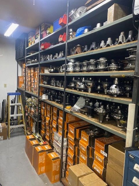

You can also check out quickperformance.com for a center section. Great prices.
Here's a couple housings.
Yes that 8.8 is a good option and can he bad for cheap with disc brakes and posi. Just needs to be cut to length on the one side.

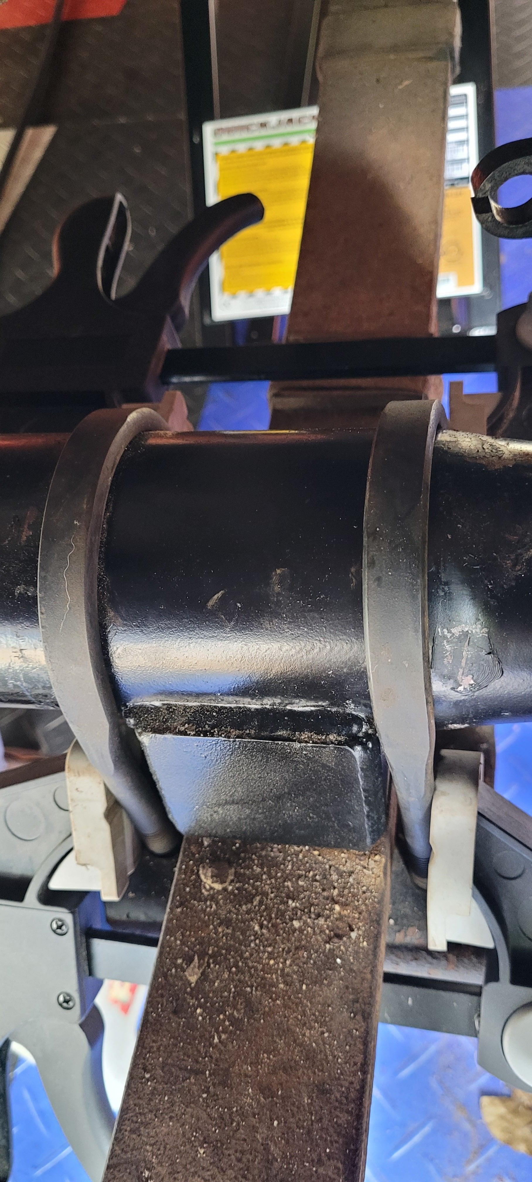

For what it's worth, I put a rear sway bar on my 67 vert that I had to remove when I installed the dual exhaust . When I removed it I found one of the square u bolts that is inserted in the frame rail had torn the rail some .
You may be better off with a pan hard bar .if you have not replaced the rear suspension bushings yet it's well worth the effort.
