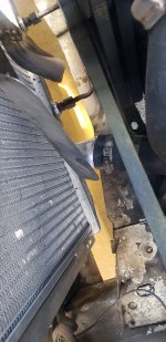

If you loosen up that lower hose clamp some (about two to tree full turns) then the hose will be able to slide back on the radator outlet then retighten the hose clamp and refill the radator. Are your radator hoses spongy / soft or are they firm? You will usally need the estimate of the repair costs for the claim, afterwards if they settle with you could do your own repairs if you wanted and save on the accual costs. Taking lots of pictures like that one above to ducument any damage that is found is very helpful to. You might also pull the spark plugs out for an inspection too. I have seen this happen before with a stuck Therm O Stat and or very soft radator hoses. Best of luck
The hoses are firm, not soft, but I will have to put a flexible hose on because this one would not fit back on. I tried for about an hour. The current hose is from a Granada because the stock hose would not fit the custom radator. I cut that hose and was able to slip it on initially, but no luck now. I think a flex hose is the way to go.
Thank you for the advice re the estimates etc. I think you're right about pulling out the spark plugs to take photos.
Something else you could try is to cut the hose in the straight part of the upper section take out about 1 1/2 or 2 inches or what ever it takes to make the bottom of the hose fit straight onto the bottom radiator outlet. Then reconnect it using a sleeve and two more hose clamps.
That sounds great! Actually great idea!
