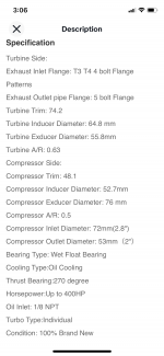

Okay, I’m completely new to the world of forced induction. I’m reading as much as possible but a lot of this is just estimating what might get me in the ballpark of a fun ride. I’m asking for help and guidance from the group that knows more than I do. Will this turbo work well on the 200 and which cam would be the best option?
I’m running a 200cid, with mostly stock components. I have a 78 large log head, non-ported with stock valves and stock springs. I know I’ll probably have to change out springs to accommodate the new cam. I’m not looking for the 200 to make all its power on the top end since I doubt I’ll be in that RPM rang much.
I'm having a exhaust manifold built to accommodate the turbo. I’m having an issue choosing the cam and turbo set up. This is what I found so far. This is not the ultimate build for me, this is just an intro and learning experience to forced induction for me. I found two cams but which one is best? I would like the cam to have just a tad bit of lope for fun and a turbo that Will spool pretty quickly. I want to run 8-10 lbs of boost…. Nothing crazy.

I would be looking at the Schneider 131H if you're not looking for power over 5000 rpm and want to focus on the low rpm end of the power band.
The 52mm turbo you posted will work for power between 2000 and 5500 rpm.

Thank you pmuller9,
I’ll be running a log style exhaust manifold. I’ll be sure to look into the Schneider 131 H, even as a kid I always had a tendency to chose too large of a cam for my application as I circled parts in the magazines . Is there any other cam manufacture that has a cam more suited for my application? I was looking at a power band somewhere around 2,000 to 5,500.
Awsome, I was afraid that turbo would be too big or not suited for the flow of the head but if it has a power band of 2000 to 5500 rpm that leaves me plenty of room. Truthfully, I don’t know if I will ever hit 5500 or 6000 rpm confidentiality without waiting for something to come apart.
