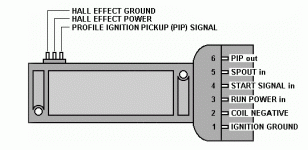

It appears that the distributor has the hall effect sensor (! I thought it would be VR ! - - once again schooled by @pmuller9 ) and then that white molded module is some kind of smartish electronics:
I would guess that the HyperSpark only needs the hall effect sensor output.
Interestingly, there is some mechanism for mechanical advance, but it is locked out at the factory.
More to learn.
If you look at the shutters, there should be one vane that is narrow compared to the other five.
If you make that vane the same width as the others and make the window between the vanes the same, the leading and trailing edge spacing will be the same and can be used to trigger the Sniper.
You can keep the white module.
Just supply power to pin 3 and ground to pin 1 and use the PIP signal from pin 6 to trigger the Sniper

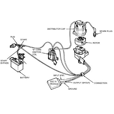

Is there any need to add a diode when customizing the EEC-IV distributor for use outside of stock electrical configuration?
There are only three connections.
Power from the ignition switch, signal and ground.
Where would you place the diode?
It was a question if one might be needed, since the distributor is getting it's voltage supply outside of the typical ECU; which would filter out any stray or non-biased voltage pattern. Adding a diode could even prevent ruining the control module if the ones in the alternator were to fail

Most all hall effects work on 5v and sensor ground supplied from the ECM. Using it through the TFI module may cause a problem on 5v, but I'd wager it'd still work. It'd be easy enough to check. To simplify things further, utilize the latest model 4.9L distributor with hall effect and pigtail only and no TFI module attached.
The 4.9 distributor worked just fine on 12 volts using the module as seen in post #29.
I would keep the module in place as a buffer between the Hall Effect unit and outside electrics.
I am reading this as, the module serving as a passive interface. It will have no duty as an ignition control module anymore?
Yes it will be a passive interface and the Sniper 1100 takes on the ignition timing duty.
It can still be used as a TFI ignition coil driver but then you are back to the heat issue that caused Ford to move the unit remote from the distributor.
