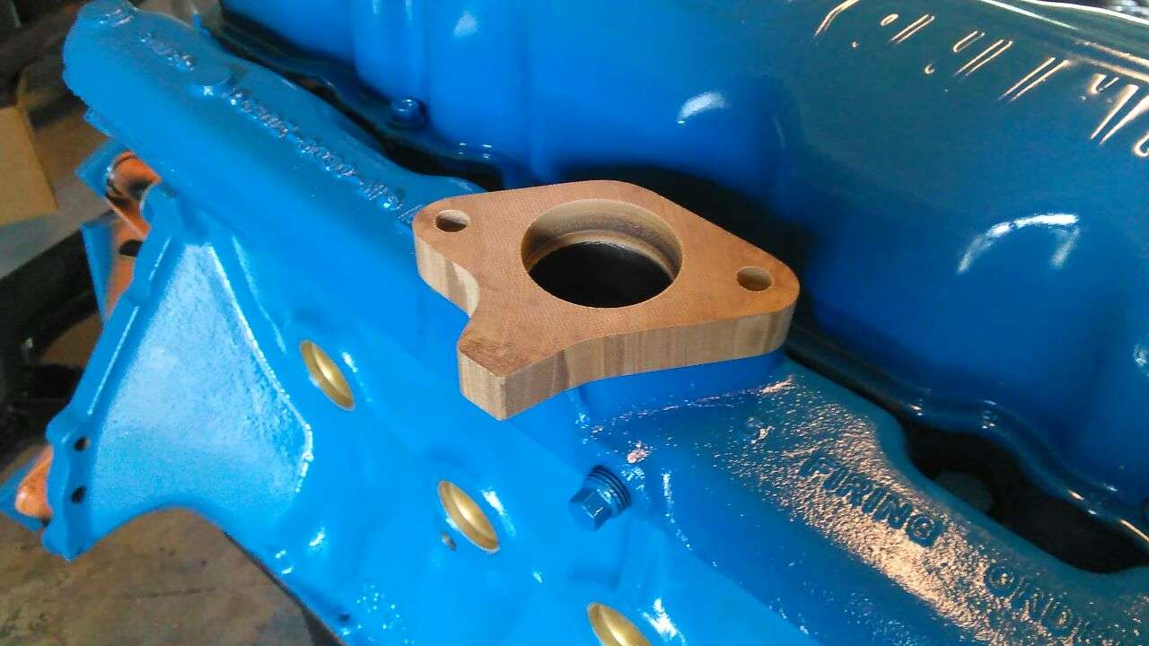

I just installed a large log head on my 1965 mustang with the 200 I6. I also picked up a Carter YFA which I plan to use in place of the Autolite 1100. The large log head has a carburetor bore of 1 3/4" vs. the 1 7/16" of the small log head. So the bore on the carb spacer for the Autolite is about 1/4" too small. I had thought about boring out the original carb spacer, but I'm not sure there's enough metal. And if I mount the Carter YFA directly to the manifold, it will be turned sideways so I'm not sure the throttle linkage will hook up. Are their other options?
Maybe the spacer made for the large log head?
That's the challenge - I can't find the right spacer. The Carter YFA I have doesn't fit the manifold holes, so I guess I either need a different carb or find a way to make a spacer. The cylinder head looks like a 1973 based on the casting number, so I'm assuming it's from a Maverick.

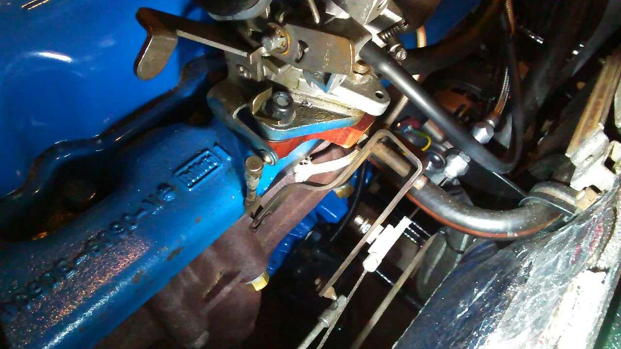

You likely won't find any of the stock large log head carb spacers that will allow you to use your stock throttle linkage on your 1965 Mustang. With the introduction of the large log heads starting in 1969 Ford also went to the cable throttle linkage to deal with how the Carter Carb's fit onto the engine. You could try making your own spacer so that he carb is ordinated correctly to use the existing stock linkage. But also know that most of these later Carter Carb's throttle arms are made to be pulled rather then pushed so they also will be turning differently around the throttle shaft pivot point. The pull cable linkage fitting will need to be moved and re drilled below the pivot point in a different location to be able to push correctly, try to match that location so that it is like what's on your old Autolite 1100, or you can just swap over to a cable throttle linkage which in my OPIN is the best system to use. Best of luck
Thank you for the info on the cable linkage! Looks like I'm swapping to a cable throttle soon.

I had to make my own out of a chunk of phenolic we have at the shop.
late model cable carb links @ junk yrd are the bomb on these conversions. Grab the gas peddle too.
