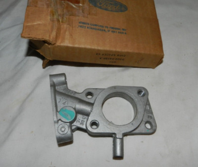

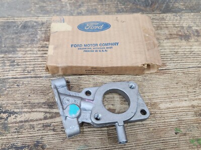

I am having a terrible time finding a carb( 1 barrel) spacer for my 250 6 cyl manifold. The manifold number,D7BE6090AB that is stamped on it, does not come up on any search,anywhere. I have tried part#VI97-17812A & B which do not align. I was sold the car without carb and spacer,and someone suggested I cross referance the manifold number, but it does not come up anywhere. I am out out ideas. Any suggestions? Thanks in advance
Here is two carb spacers on eBay:
