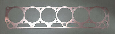

So I'm contemplating upgrading the gasket. I found the following guy on Ebay selling copper gaskets for the 200. I was planning on using copper spray on the gasket to tack it up a bit to ensure sealing of the coolant and oil passages. I do drive my car on the street, but I don't have experience with this type of gasket material. Bad idea? Stick with a Felpro? Appreciate any insight.
