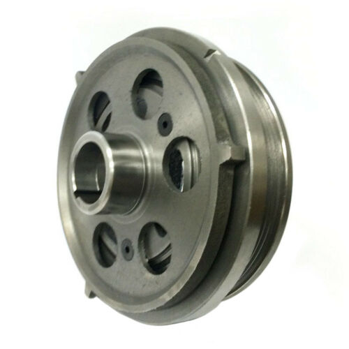

The 1996 Ford 4.9 harmonic balancer has a space on the back for a trigger wheel.

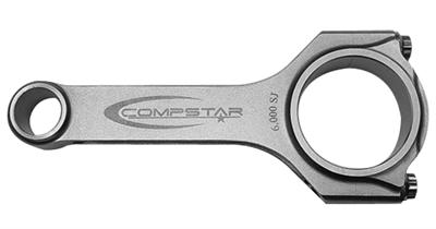

Third: There are two aftermarket connecting rods that fit the 300 six if you choose to build a very strong bottom end.

What other rods are available besides the molnar?
Small journal BBC rods, 6.385" long for a 2.100 crank journal.
The BBC rod is a little bit longer than the stock rod which improves the rod angle and reduces piston side loading.
Compstar CSB6385DS3B4AH
Here is a picture of the Compstar rod with the Autotec piston for the 300 six

You still use a stock replacement position for a 300 with the bbc rods or do you have to go custom?
Custom, the BBC rods are longer than a stock 300 rod, so using a stock replacement 300 piston would put it above the deck

What jgavac said since that is his rod and piston showing in the above photo.
Additionally the Compstar rod uses a larger .990" pin.
The Compstar rod is a little bit longer than the stock rod which improves the rod angle and reduces piston side loading.
Even if you use the Molnar 300 six stock length connecting rods, there aren't any forged pistons available and you would need a custom piston anyway.
