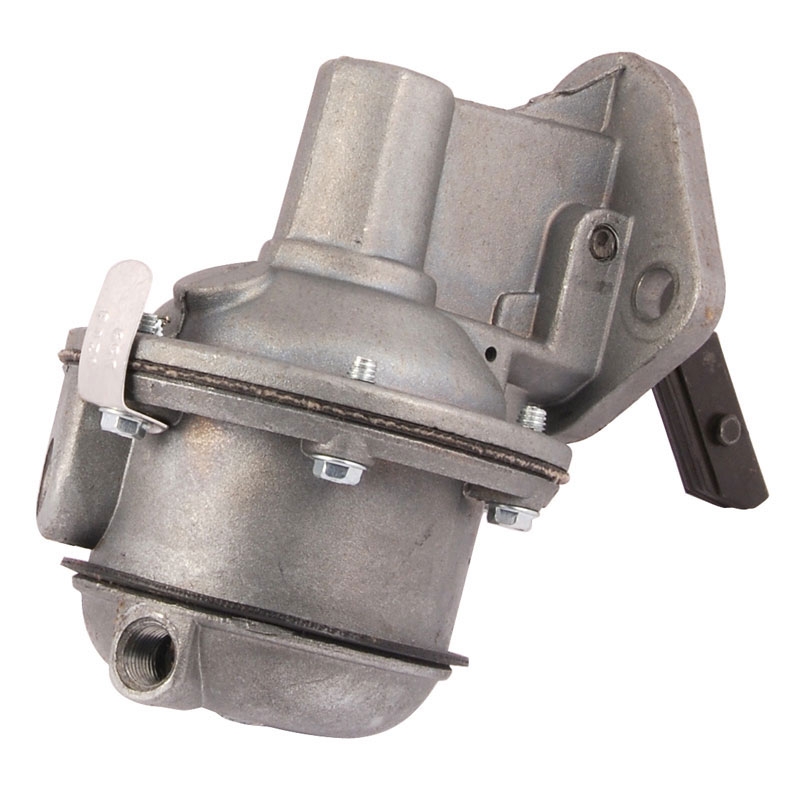

Went to fire up the 63 Galaxie for the spring after new plugs and fresh oil and filter. Started it and the fuel pump started spraying fuel out the middle of the pump from the diaphragm. I was looking on Dennis Carpenter for new pumps and they have several different ones, anyone know which one I need for mine? I want to get it replaced and drive it ASAP, I just have that itch to drive it lol
Hi GTPicker, the Stock 223 Fuel Pumps will look like this (see below Picture) look for that shape of the engine mounting pattern / gasket and that type Internal Lever Arm. Depending on the year of the car of truck the early ones could have a Vacuum Pump on top to be used with the Vacuum type Windshield Wipers, or a top Mounted Fuel Filter such as yours, or nothing on top like in the below picture. I really like those Top mounted Fuel Filters since they are larger than inline filter types and are fairly easy to change. Good luck
