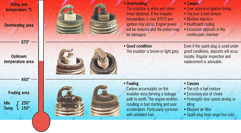

Post upa pic of how they've burned...

For the heat range, there are several ways to determine. This is one from Mike Canter:
Mike Canter said:
Spark Plug Heat Range
If you keep on adding timing until your finish MPH falls off, but you still have no color on the plug’s ground strap, but the porcelain has good color then your plug is too cold.
If you have lots of color on the ground strap, but the porcelain is clean and white, then the plug heat range is too hot. The heat from the plug is cleaning off the fuel ring from the porcelain
Your application is for street, with much greater range demands, so consider that in how you're testing for heat range. Read the whole thing here: https://www.dragstuff.com/techarticles/reading-spark-plugs.html
From Jeff Smith, the whole point of heat range:
Jeff Smith said:
The key to a heat range selection is related to selecting a plug that will efficiently burn-off carbon deposits from the center ceramic during normal use of the engine.
I'll note that Jeff's default and mine are a bit different. Jeff's goal is the same, but I use the coldest plug that will stay clean. He uses the "hottest that will survive". Unfortunately, IMO that's dangerous, as a too-hot plug can induce detonation or destructive pre-ignition. A too-cold plug will not stay clean in your normal use, resulting in (at worst) misfire if they foul. I think that's the safer route or direction to approach, but your call.
Another good reference to help fill-in the holes: https://www.crankshaftcoalition.com/wiki/Reading_spark_plugs
Finally, as heat range is strongly affected by other factors, such as tuning, here's this:
