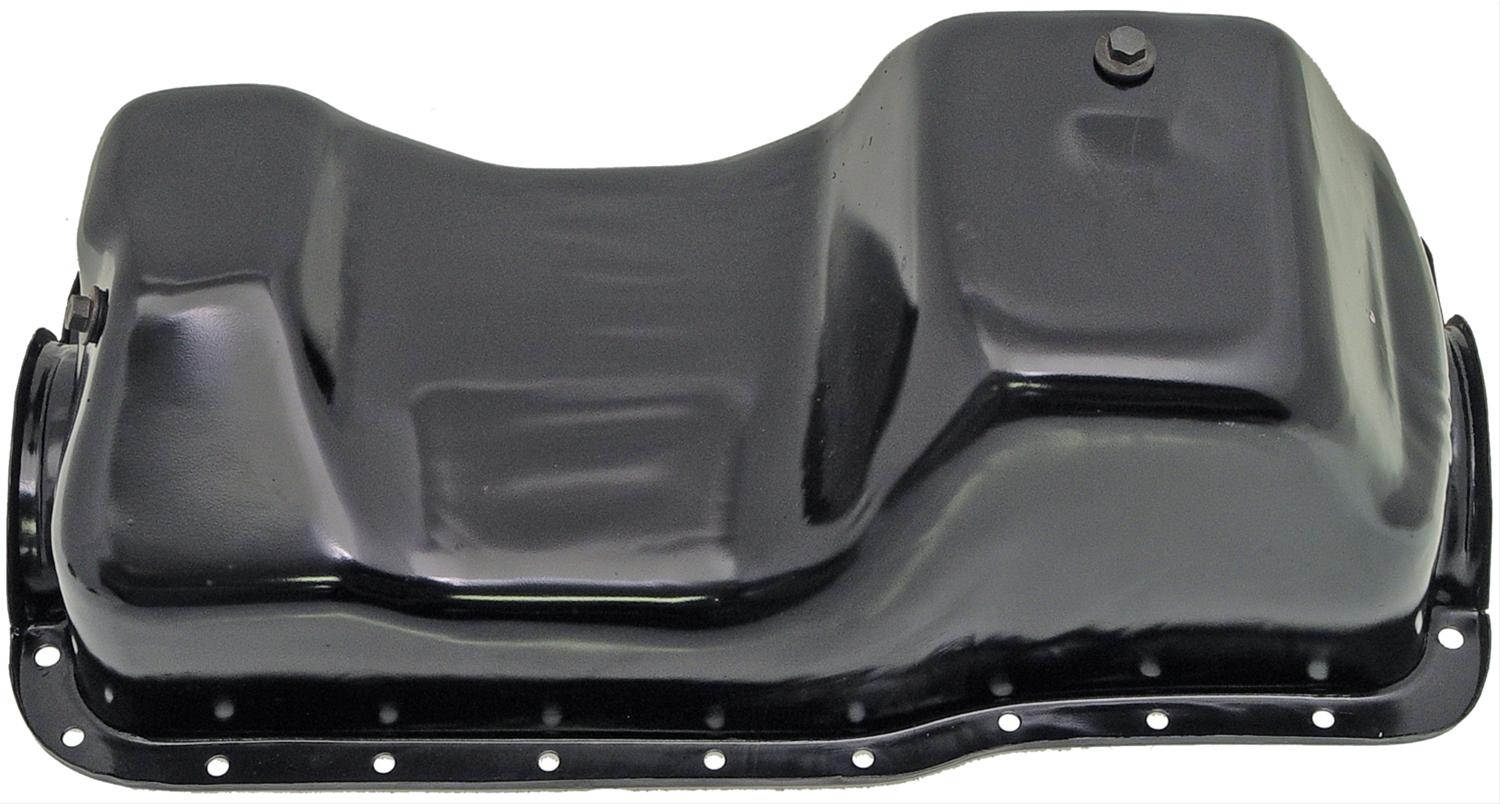

I would not run light multi weight oil without building an oil pan baffle too prevent the oil pickup from sucking air when braking. The Fairmont pan may not have this problem. An oil pressure drop may not be noticed if running an idiot light or an electric oil gauge.
I believe that many Fairmont 200 oil pick tube mounts break where it mounts to a main bolt-stud. The pickup screen may be resting on the bottom of the pan.
The pickup tube mount was broken on the Fairmont 200 engine that I put in my Falcon (before I changed the pan + pickup to a 1965).

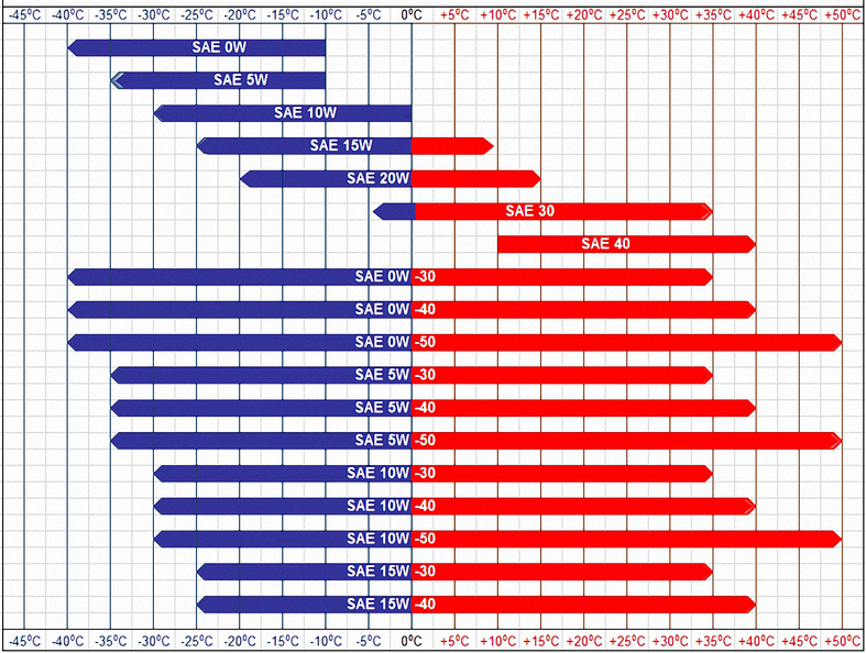

seeing that chart made me go look for one. I think this is a decent article as well as a chart that explains whats going on, especially to those, like me, who have had difficulty understanding oil-weights.
The "W" after the first number is for 'Winter'.
According to the Haynes manual 15W is good down to + 10F.

Wasn't the fairmont a double sump (w/bigun in frnt)?
The Fairmont oil pan was double sump (with broken pickup tube mount). The Fairmont pan might be could for a Mustang II front end conversion on an early Mustang-Falcon with a small six. The small front sump was for oil pump clearance. It can't be drained.
