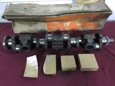

I'm definitely confused with this crank found on E-Bay, :cool:
Yeah I think who ever is selling that crank on eBay is confused it obtusely can't be for both a 170 & 200 engine. We would need to have a stroke measurement or at least some casting numbers off it to know what it's for. It looks like a 170 crank to me but I could be wrong. A set of 170 or 200 forged rods with a 200 stroke would work not sure what pistons would fit except for those 181 six'es that they made in Austraila.
