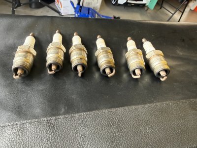

Not sure why, but first thing I've decided to pull spark plugs out lol. One of the spark plug wires came undone at the spark plug.

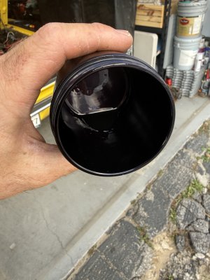

Also, per @awasson suggestion I put an oil catch can for PCV and during that short period of engine running, I think it accumulated quite a bit of oil.

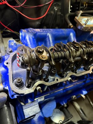

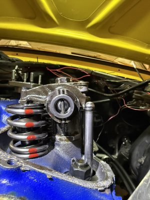

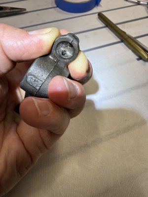

JK, took @drag-200stang and @awasson advice of taking apart as needed and started with valve cover and boom…broken arm on the first cylinder.
All pieces were there, I’ve tried putting them together as careful as I could (to see if there were missing broken off pieces) and it seems that everything stayed under the valve cover. Can’t see any other small pieces broken off from there and everything puzzles back together.

Should I be looking for a whole rocker arm assembly, or can I get just one arm replaced?

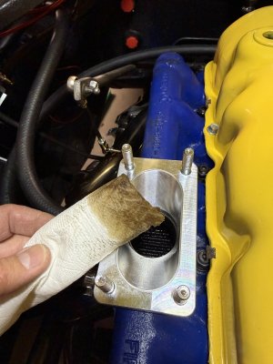

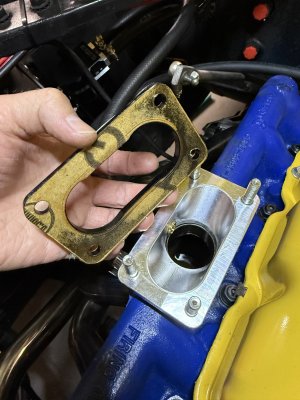

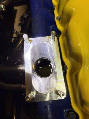

But while taking things apart, I’ve got another concern now - my carb.
After initial break in and when I realized that my transmission does not shift into gear, I put car on stands to remove the trans - and noticed at that time, that my carb was leaking gas at the spacer area (spacer came with 2 thin gaskets glued to it and i didn’t use any other gaskets). I don’t know if that is normal, but I assume that it happened when I was lifting the car from one side and everything was tilted.
Now, when I was removing it, the spacer with glued gaskets was soaked in gas, adapter had gas on it as well (flat gasket surface) and inside intake manifold was little puddle of gas. Is that normal? Or should I be concerned about?

Broken/damaged rocker arm usually from incorrect lash adjustment. Usually too loose, the parts are "slamming" together. Oil starvation is another possible cause. Pushrods need to be checked for bent also. Rolling them on glass is a good way to know if they're straight.

Is you fuel pressure too high for the Weber carb? Does your fuel system allow pressure to bleed off after engine is off?
Someone around here might have one in a misc. junk box. You can often find a single rocker on eBay, more often NOS than a single used one. Watch out for a whole used assembly on eBay, they are often completely worn out. How tight are your arms on the shaft, lots of wiggle room or no? O'Reilly's has new shafts reasonably priced, a machine shop could re-bush the arms for you.
Since you are going to have to pull the entire rocker assembly, I'd double check for any bent rods. I thought for a second that it could be improper lash, but you have non-adjustable rockers. Possibly just a defect in the rocker casting. Look for voids in the casting across the fracture. Are you running heavier valve springs than stock?

@Frank my rocker arm is non adjustable and I got all new push rods.
As for the carb issue - I don’t have a fuel pressure gauge before or after the pressure regulator - should probably check that as well. I have Holley fuel pressure regulator 1-4 psi, which comes preset from factory to 2.7-2.8 psi. The only thing is that it takes up to 7 psi inlet pressure - not sure how much mechanical fuel pump puts out.
And I’m not sure about pressure bleed off…is there should be a valve or anything like that? Now I have mechanical fuel pump into fuel pressure regulator and then into carb.

Springs are not stock, but that’s the one that were recommended by Nic at ClaySmith Cams. And he said I can run them with non adjustable rocker arm. https://claysmithcams.com/valve-spring-set-single-spring-5-000-rpm-and-under/
@TrickSix I got new shaft, when I was cleaning up the rocker arm assembly. My only concern is that the studs were hard to put on, but arms were good and moving freely.
@frozenrabbit i didn’t check all the rods, but they were brand new before installation. I did roll the one that broke off and it seemed straight. And yes, heavier springs that were recommended by Clay Smith.
