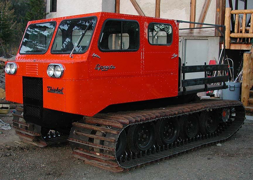

Cool! The Snowcat looks to be in great shape. Some pictures of the engine bay area would help, as well as be interesting! I would think that a 200 should be pretty much a bolt-in. But I'm not sure if there's anything unusual about the transmission in a Snowcat. As said, the extra power from a bigger displacement engine should be noticeable, and there are a few simple and cheap mods to help. I'm not sure if your money would be well-spent doing a lot of extra work on it. Since the engine will be used in cold weather, it might be a good idea to see if the fuel injection systems work better than a carb in below zero temperatures. They are expensive, at least the one barrel version doesn't require the extra head work a 2 barrel does. Good luck with your project!
Well, that isn't my cat in the photo...it's a shot I grabbed off the web. But mine is the same, albeit with dull paint and a roof rack. Honestly, I believed it was a 200, until a friend showed me the 170 plate. But who knows.
