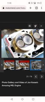

Like the Kaase MEL?
Actually never heard of that but what I had envisioned was not extending the chamber out like this (I wasn't smart enough to envision that working) mine was more or less like a normal valve seat but way bigger lol and than I added the sleeve portion to extend down into the throat but immediately realized it's probably not worth it unless you really needed some kind of special coating or resistance to high heat or nitrous or something. But the super seat idea I still like.
