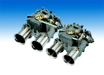

some of the 2.3L turbo guys are running side draught intakes for webers with a plenum bolted in place of the carbs with a single forward facing throttle body. I think this would be a hot ticket on a force feed 200 with this head or even on a 250 2v head for that matter.
Will the fuel injection setup be available with chrome or polished aluminum horns in addition to the carbon fiber horns...you know, for those of us who still like the older look.
I'm thinking about making a cast alloy plenum with raised ribs (to match the alloy valve covers) and a front or rear mount throttle body. Would look pretty cool IMO.
There are all sorts of aftermarket horns available for the webber style TBI/Carbs. I just chose the carbon fiber for the SEMA show as they matched the black valve cover and gave it an updated appearance.
I've seen polished aluminum and steel, brushed aluminum, red and blue anodized, powder coated, neopreme, colored plastic, wire and foam, etc. Take your pick. You can get foam socks and vinyl caps for the horns. The caps slip on like tupperware lids to keep dust and debris out when parked.
