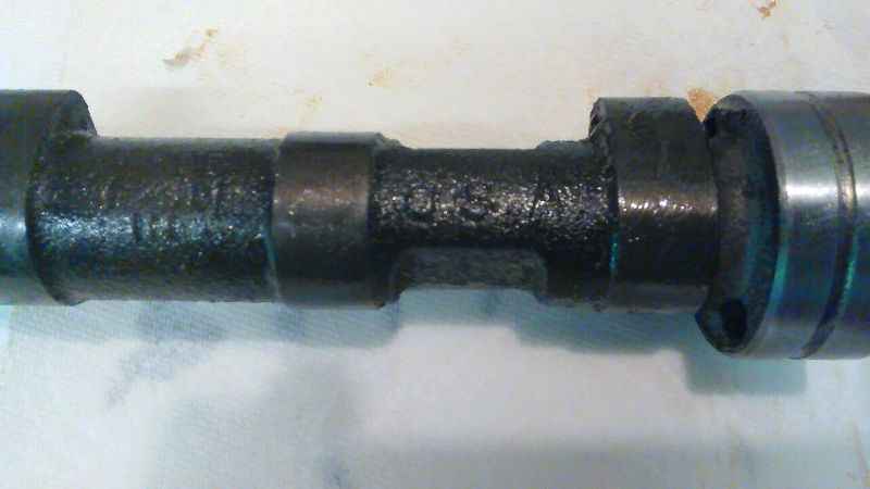

It's been a while since there was an update on my build. I finally got my cam from Schneider. Got a new crank key, I dismembered mine for the pos Erson cam. Installed it on the marks and it degree'd right in on the numbers. There was ~.003" run out but some of that may be in my setup. Grinder off thing like the Erson but better controlled and indexed right to the marks when installed.

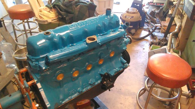

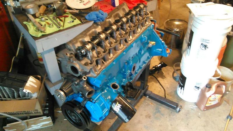

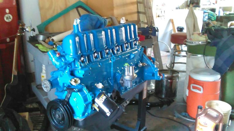

Having done that I installed my head, a nos shaft, perches and shaft springs with the good rockers off the 78 cracked head. Sunday I got the water and fuel pumps, the thermostat and senders installed, painted the top end and air cleaner. I realized my oil pump shaft was worn and have a new one of those coming and some odds and ends. I hop to get it married to the aod and installed in the van weekend after this coming.
