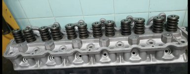

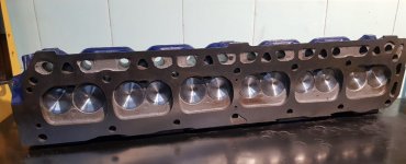

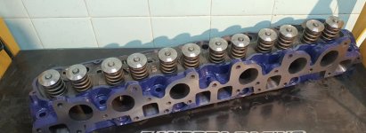

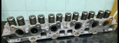

I can get them imported cost is about $3200+ for an aluminum head as of today(Price keeps going up) depending on what work has been done. I can also get cast sprint head. That runs about $2400+
Some examples of the aluminum

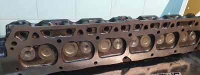

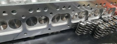

I can get them imported cost is about $3200+ for an aluminum head depending on what work has been done. I can also get cast sprint head. That runs about $2400+
It's good to know the heads can be imported. Does the $2,400+ for the Sprint head include an intake manifold?
Cast.
