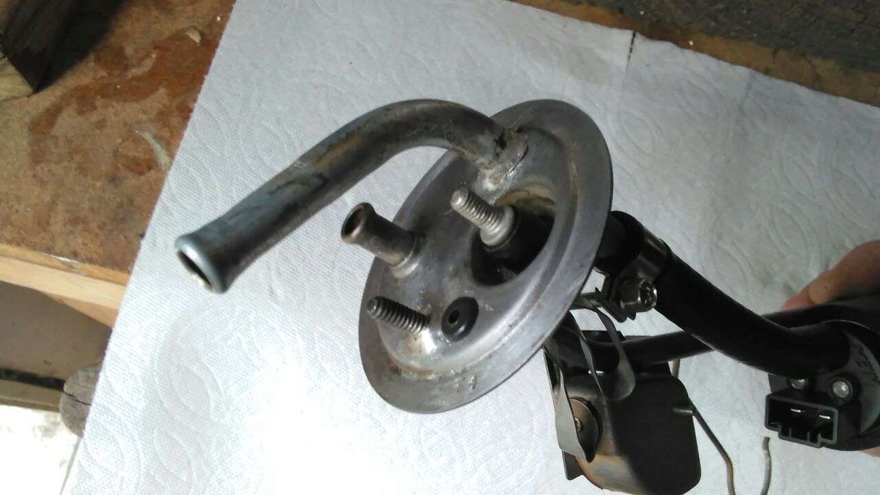

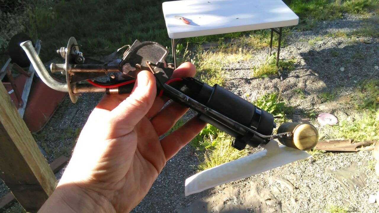

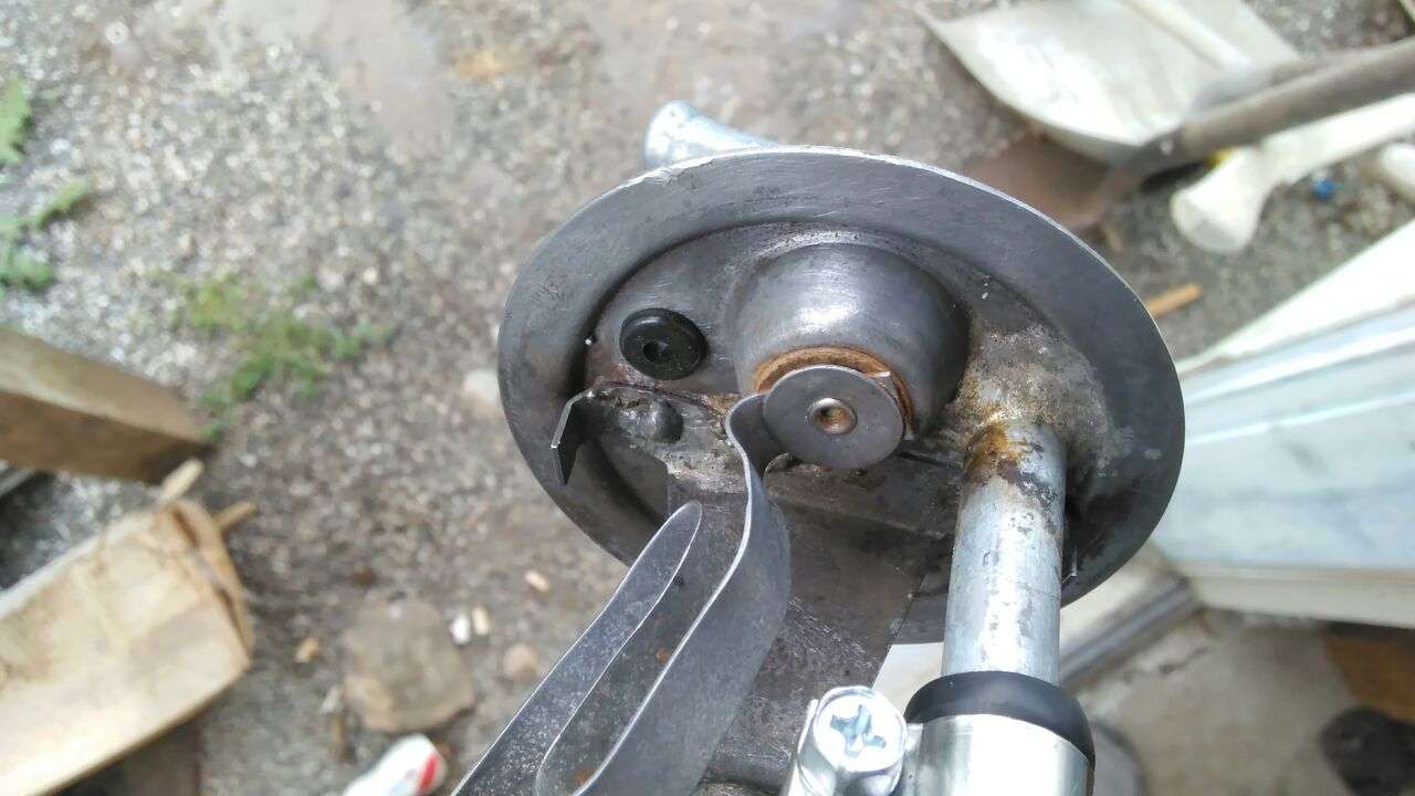

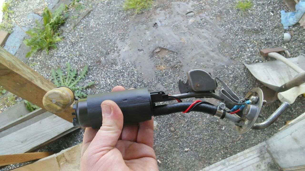

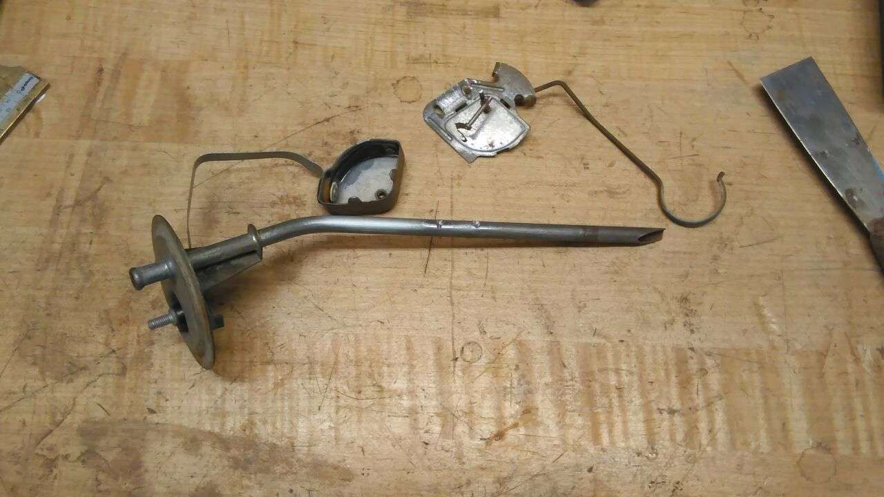

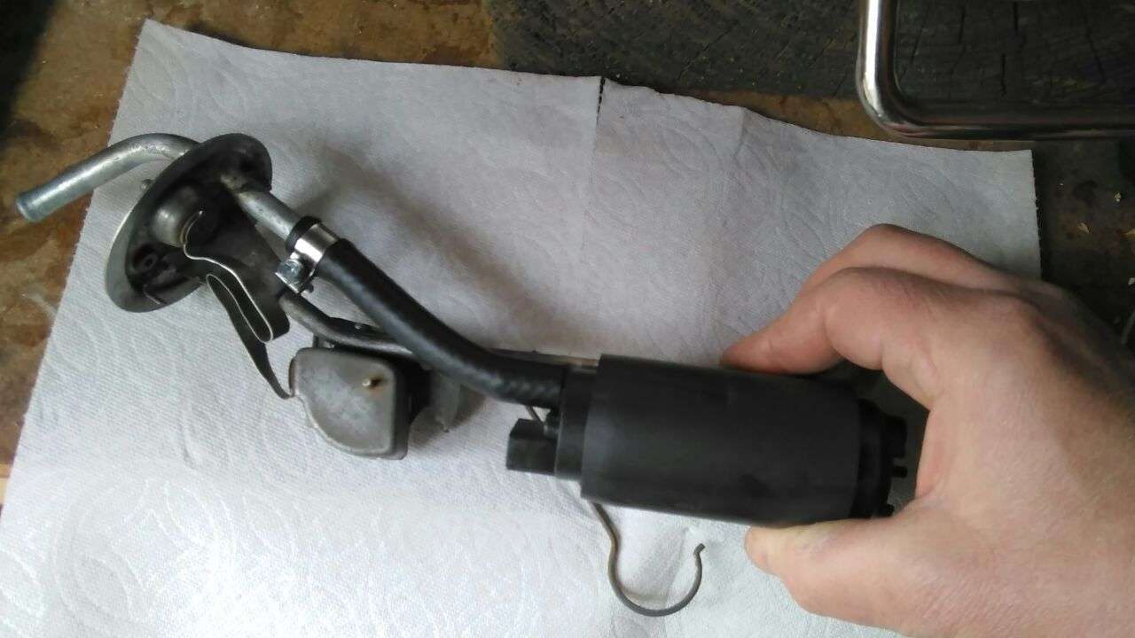

This is what I did, do it at you're own risk. It's working great for me. AEM 50-1000 fuel pump and a pick-up sock from some Dodge, Mazda(Maasda for you Canadians ;)) or something. I think it's in the original post. So far so good in the Econoline tank, quiet until the tank is empty. You hear it prime, but then it's gone. It's quieter than my 93 Bronco or pickup. The Sniper is running good.
So I still have the whole unit. I'm considering using it again in the future. I'm honestly really happy with the Street Avenger for now so I think I'll keep it in the Ranch. But if I end up keeping my 63 Falcon long term, I'll probably add something like that to it it just go with the EFI tank. I'm not sure with the direction of that car yet, trying to focus on the Ranch. I do know after I get the aussie head I will be supercharging it. I'm pretty sure about that.
