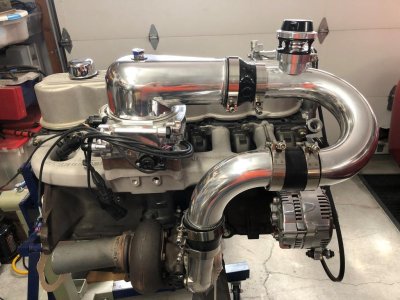

Is there a preferred location/distance for a wastegate? I planned on installing a wastegate right next to the turbo on the 1-1/2" pipe that taps off the 3". But it might be less cramped if I extend the 1-1/2" and move the wastegate farther away from the turbo where it will tap into the turbo exhaust.
A 35mm Turbonetics 10780 Evolution Wastegate.
I've been finishing up some final details before sending the engine to the machine shop. I believe I'm ready. Now I just have to find a good shop!
