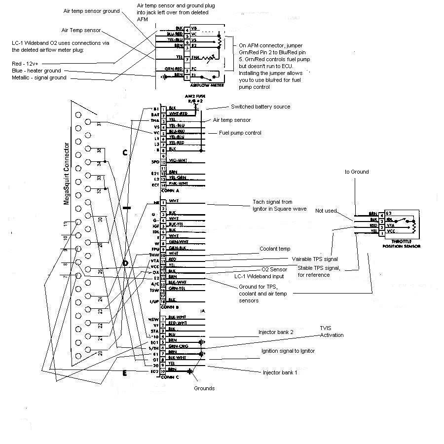

What follows is Non Plug and Play 5.0 1986 HO Mustang V8 related, a Sequential Port EFi and Sequentially injected Speed Density Mustang. It gets downgraded to a non fault coding, bank fire, non sequentially fired, De wired, non EGR, non AIR, non Purge Canistor system without AC.
xctasy":1jgddk2e said:
An EFI system requires an amazing amount of wire to hook everything up, including fuses, relays, power and ground wires plus sensors and controllers.
But you can get away with as little as this:-
Sensors include
1.air and
2.water temp,
3.wideband O2
4. throttle position.
5.You have to cut the two 10 pin plugs for the wires for the eight ( 8 ) injectors,
6, idle air control, ---->PWM IAC Fiddle Vale or Board
7. the new fuel pump relay
8. the TFI ignition module (including SPOUT)
The only two wires used used from the original harness would be
9. are ignition start and run that hook to the starter relay.
10. Neutral Gear Switch you'll have to copy the system.
See https://www.diyautotune.com/support...d-eec-iv/assembling-the-eec-iv-adapter-board/
What works is mapping out all 37 pins of the MS2 to the 10 outputs.
On my Toyota RAV4, i used John Laughs wiring schematic in paint
"https://www.diyautotune.com/wp-content/uploads/ms_connector.jpg"
The way to link it all is to take the 37 pin MS2
and match it to the items 1-10 below.
Sensors include
1.air and
2.water temp,
3.wideband O2
All you are doing is making a Wire harness like in item 56 below.

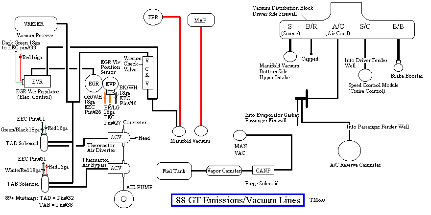

Here is your tie in wiring.
The EECIV things you have eliminated are:
1. Charcoal Canister Purge---> Now Tank will pressurize
2. Thermactor Diverter and Bypass TAD/TAB (Upstream and downstream AIR control)
3. Fuel Pump FPR control---> Now MS2
4. IAC control----> Now MS2
5. EGR control (Vacuum and Vent Solenoids)---> None
6. What was called Neutral/ Drive Switches
7. An aspect of Crash Inertia Sensor operation ---> None if you don't take steps to re-establish the Fuel Pump FPR control Now by MS2
Standard Group EECIV controls were
Inputs were:
Out puts were
MegaSquirt 2 has an Input/Output/Control system map. so does Fords EECIV.
When anyone goes off the EECIV sheet, they then have to establish
1. another way to ensure the tank doesn't pressurize,
2. the Inertia switch works, and
3. that the Neutral / Drive switches operate.
4. The VSS sensor is just used for Speed control, but is used for other things on some Speed Density Fords.

nigel":19ni0l63 said:
Thank you for the breakdown, this helps bigtime. Im currently in the parts gathering stage; gonna try and find an sn95 relay/fuse mount if i can, or just mount an aftermarket fuse block on some kind of nonconductive panel on the passenger fenderwell, new plugs for the sensors, and one chip for the ms2 thats fried and im gonna have to pay shipping for lol
does the fuel cap being vented not serve this purpose?
and if they dont? wont it be like an older car that you can just start with the clutch engaged?
1>http://vb.foureyedpride.com/showthread.php?142515-Purge-valve
martin0660":19ni0l63 said:
Not 100% clear on the question, but the EFI 2.3 turbo stuff had a simple system. The vent line from the tank went to the charcoal canister, then a flex line (I think what you describe as cheap flex) went to an elbow between the stock air filter housing and the VAM meter. Anything coming off the canister was drawn into the VAM then into the engine. No solenoid, no control at all.
I think this is what you was asking about.
note Nigel... in this case VAM is MAF, and the purge valve goes into the positions here below.
86 and 87 5.0 HO's differ only slightly
veci_86_ho_50_29188d1344026155_vacuum_lines_plastic_vacuum_line_routing_out_zps0f9efcce.jpg
The 86 upper intake has unique porting
The 86 PCV long hose that does a 180 degree loop
Mar 23, 2016 https://www.stangnet.com/mustang-fo...nection-on-a-1987-intake.890038/#post-8960203
jrichker StangNet's favorite TOOL":19ni0l63 said:
Notice the large rubber hose that goes off screen....That connects to the solenoid valve that connect to the charcoal canister that connects to the....
manifold_upper_underside-sized-jpg.553015
Charcoal canister plumbing - one 3/8" tube from the bottom of the upper manifold to the rubber hose. Rubber hose connects to one side of the canister solenoid valve. Other side of the solenoid valve connects to one side of the canister. The other side of the canister connects to a rubber hose that connects to a line that goes all the way back to the gas tank. There is an electrical connector coming from the passenger side injector harness near #1 injector that plugs into the canister solenoid valve. It's purpose is to vent the gas tank. The solenoid valve opens at cruse to provide some extra fuel. The canister is normally mounted on the passenger side frame rail near the smog pump pulley.
attachment-php-attachmentid-58191-stc-1-d-1241921055-gif.553012
It does not weigh but a pound or so and helps richen up the cruse mixture. It draws no HP & keeps the car from smelling like gasoline in a closed garage. So with all these good things and no bad ones, why not hook it up & use it?
The purge valve solenoid connector is a dangling wire that is near the ECT sensor and oil filler on the passenger side rocker cover. The actual solenoid valve is down next to the carbon canister. There is about 12"-16" of wire that runs parallel to the canister vent hose that comes off the bottom side of the upper intake manifold. That hose connects one port of the solenoid valve; the other port connects to the carbon canister.
The purge valve solenoid should be available at your local auto parts store.
Purge valve solenoid:
6-jpg.553013
The carbon canister is normally mounted on the passenger side frame rail near the smog pump pulley.
Carbon Canister:

Since EECIV is now gone burger, and the wires to Pin 31, and Pin 37/ 57 are to invoke Vacuum Pulse Width Modulation cycling at about 200Hz at 100% duty cycle, then I'd suggest you manually purge with a rocker switch when required.
for Purge
EGR (http://vb.foureyedpride.com/showthread.php?177608-Installing-an-EGR-system)
even the Fox LTD/Marquis/ Lincoln/Panther Trip Minder (http://vb.foureyedpride.com/showthr...C-IV-Pin-34-Data-Output-Link-PWM-Data-produce) ,
there is a project wiring process that can be laced in later on. mrriggs is a member at FEP, FSP and at http://www.gofastforless.com
He does a whole bunch of TFi/EGR/TripMinder stuff for a small fee that others charge 500 dollars a try...
