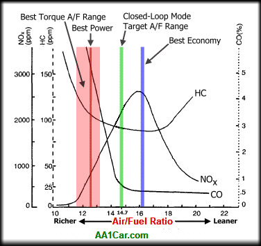

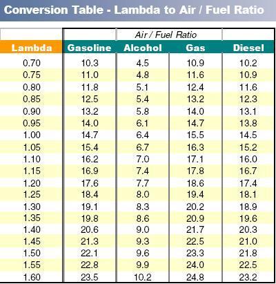

AFR = lambda x stoich, always
"https://www.aa1car.com/library/air_fuel_ratio_chart.jpg"
lambda-jpg.512459
"https://www.theturboforums.com/attachments/lambda-jpg.512459/"
