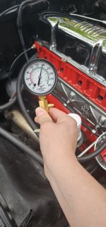

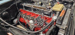

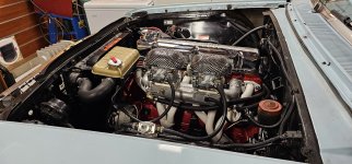

Granted, this is in a car with 3:55 rear and 14" tires...but I've been enjoying the hell out of my built 223 and the last several fill ups after I got the cruise and part throttle vacuum advance canister right, I've averaged 26-28mpg!! The other day I surprised a fart can tuner when I stood on first struggling to get any kind of traction and left marks hitting second standing on the 5500rpm redline...haha its such a fun little engine now!
@bubba22349 check out the cranking compression now! 😈

Galaxieinline, I believe I’ve seen your videos on YouTube, great sounding 6! And great numbers too! Currently I’m running 3.90 gears close to 3k on the tach at true 60, my Speedo is slightly off. Do you have an overdrive? Those numbers are amazing
Wow GalaxieInline, that's some great Cranking Compression NOW! I can only imagine how much fun your having with it.
