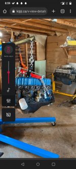

I found this in canada code is. C6DE 6015 B what does the B stand for.
Says it's good runner.

The last letters in the design code are the number of Revision's or Improvement's to that engine block and will designate how many times the part was improved. With A being the original part design, you might see other blocks with an AA, B, BB, etc. so that part was at least the 2nd and maybe as much as the third design Revision.
