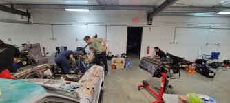

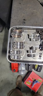

We brought the car in and cranked it with no spark or fuel and it definitely sounded like a bad knock. We tore into it and main bearings were fine, but the #1-2-3 rod bearings were on their way out.
It was around this time it became clear my digital torque wrench wasn't to be trusted. Our previous head gasket issues matched being under-torqued, then the bottom end nuts came off way too easily Vs their torque specs. Also, the flywheel bolts were backing out and were basically finger tight. Allow me to not recommend the HF Quinn digital torque adapter thing.
Anyway, we still had no idea why 1-3 were eating themselves and no spare bearings, so we drew deeply from the "if it's stupid and it works..." well and re-arranged the best bearings into the tops spots along the length and put the worst ones back at 4-6 as they were apparently less stressed. We put it all back together but it was still making bad knocking/clacking noises.
Time to swap in the $80 craigslist backup motor. This thing was an untouched "swapping my Maverick to a V8" CL buy that I put a small-CC milled head onto. Didn't look at any bearings or swap the cam over from the other engine. We got it together and fired it Saturday morning about an hour after the green flag.
It sounded shockingly good and was holding oil pressure and temp so we sent out our first driver. Alas, like 1 lap later it was running 230s temps. That head ended its last race overheating with a suspected blown HG. I need to get it checked for cracks or warpage (apparently). In a moment of desperation, we added a bottle of Blue Devil Head gasket sealer stuff into the cooling system. It held in the garage, idling for the prescribed 50 minutes, but again overheated after like 2 laps on track.
At that point we gave up on the high-comp head, we then swapped the large CC head from the original race motor on. Probably gave us like...8.2 CR and 90hp with stock pistons and stock cam.
